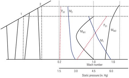

Figure 2 shows a typical static pressure and Mach number distribution. The low pressure at the hub of the rotating blade (Ps1) produces a low root reaction, which eventually leads to flow separation within the rotating blade. The Mach number at the stationary blade exit (M1) has a very strong gradient, raising the inlet Mach numbers (Mw1) at the hub and tip of the rotating blade. The high pressure at the tip produces high absolute values of the exit Mach numbers at the hub of the stationary vanes and high relative inflow Mach numbers at the tip and hub of the rotating blade, which trigger shocks within the rotor passage.
2. Tracking the field. Typical Mach numbers and static pressure distribution of a steam turbine last-stage blade. Source: H. Stüer, ASME GT2005-68746
