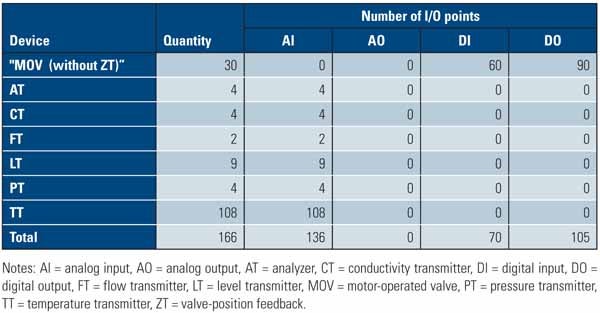

Table 1 lists 166 candidate field devices and 311 related I/O points for this typical circulating water system. The discrete I/O points associated with the pump and fan controls used in the circulating water system are not included because they are more appropriately controlled by using Profibus technology. In addition, this example does not include monitoring of the vibrations caused by the pumps and fans because these devices are usually wired to a packaged vibration-monitoring system. If this example also included discrete control and vibration monitoring using a diverse fieldbus-based system, more benefits could be achieved.
1. Field devices and related I/O points of the circulating water system. Source: Jack Y. Zhao
