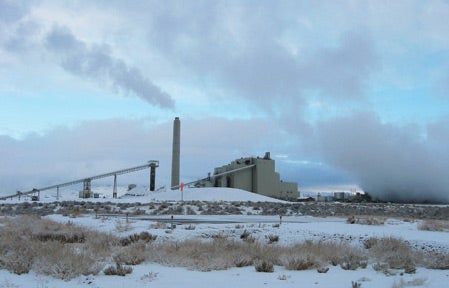

The water supply for this high desert facility comes from groundwater less than 200 feet below the desert floor. One groundwater well supplies water to the plant’s raw water makeup pond via a 2-mile-long pipeline. An additional well is located at the raw water makeup pond as a backup well. This water is used as makeup for the mechanical draft cooling tower, service water, scrubber, and coal- and ash-handling systems.
Cooling tower blowdown, after nine cycles of concentration, is sent to one of the four lined evaporation ponds, each 21.5 acres in cross sectional area and 3 feet deep (Figure 3). A smaller on-site well supplies domestic water needs and boiler water makeup after passing through a reverse osmosis (RO) system and a mixed bed demineralizer. Boiler blowdown and RO reject water are discharged to the cooling tower and recycled.
3. Zero discharge. Cooling tower blowdown and plant wastewater are collected and transported to one of the plant’s four lined process discharge ponds to evaporate in the dry heat of Nevada’s high desert. In the foreground is the coal pile storm water runoff evaporation pond. Courtesy: Fluor Power

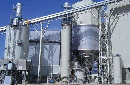

Two approaches to reducing stack mercury emissions were demonstrated: sorbent enhancement additive (SEA) to the coal and HPAC injection upstream of the SDA. Both the sorbent and reagent addition systems were supplied by contract, as part of the new boiler and AQCS (Figure 4). The summary results show that stack mercury emissions can be maintained below the permitted emissions levels with moderate additive injection rates of less than 400 ppm by weight of chloride added to the coal and less than 1 lb/Macf HPAC added to the air heater outlet flue gas for the particular Powder River Basin coal used.
4. Get the Hg out. Full-scale mercury reduction testing was completed over a seven-week period in May and June 2008 for a wide range of boiler operating conditions and mercury-reducing additive injection rates. The tests confirmed that mercury emissions were reduced to below the extremely low levels required by the plant’s air quality permit. Shown is a portion of the plant’s air quality control system equipment. Courtesy: Fluor Power
Further optimization testing showed that acceptable stack mercury emissions less than 0.02 lb/GWh were obtained with various combinations of chlorine addition less than 500 ppmw and HPAC injection less than 2.0 lb/Macf. This test data confirms that TSPP meets its demanding mercury emission permit limits.
