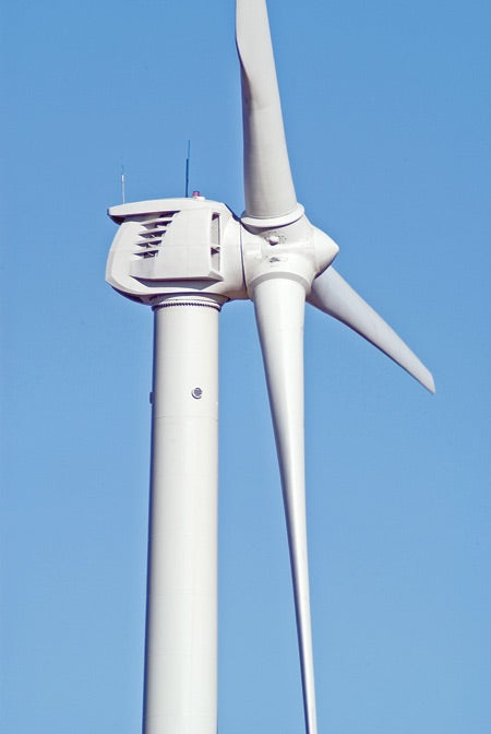

This project represents the debut commercial application of Clipper’s new 2.5-MW Liberty wind turbines (Figure 2). “We’re delighted to feature some of our first Liberty wind turbines as a part of this milestone wind energy project,” said James G.P. Dehlsen, Clipper’s chairman and CEO at the plant dedication. “Built in America’s heartland, the turbines will be helping to restore beauty and economic development to the local area as they bring new clean, sustainable energy to the people of New York.”
2. Steal the wind. Steel Winds was the first commercial application of the new 2.5-MW Liberty wind turbine. Courtesy: Clipper Windpower Inc.
Clipper’s 2.5-MW turbine is now the largest wind turbine built in the U.S. (Figure 3). The Liberty turbines have demonstrated full rated power generation with a wind speed of approximately 25 mph, as designed. This project will sell capacity and renewable energy certificates to Constellation NewEnergy through 2009.
3. Biggie-size it. The Clipper Windpower turbine is the largest wind turbine built in the U.S. Courtesy: Clipper Windpower Inc.
