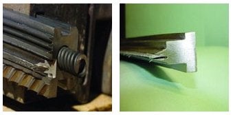

The steam seal optimization package KeySpan chose came from TurboCare Inc. (Chicopee, Mass.). In it were standard labyrinth packaging rings, retractable packing rings, brush seals, and conventional blade and brush-tip seals—all sized for Unit 3's turbine. Seal rubbing is not uncommon in steam turbines, and it is particularly common with single-casing HP/IP designs that use a packing box to seal the flow between the HP and IP sections.
A relatively long bearing span often initiates a rub in the mid-span seal area. Conventional packing can open after the first few turbine starts, leaving blade-tip seals with as much as 0.025 to 0.040 inch of clearance for years after the first few restarts after an overhaul. The retractable packing included in the TurboCare package maintains a 0.015-in. clearance by using springs to force the packing ring segments away from the shaft during start-up. For the shaft seals between stages, brush seals were added to the body of the retractable packing, reducing clearance to nearly zero (Figure 8).
8. Sealed up tight.
Installing a new brush seal (left) and brush-tip seal (right) significantly reduced steam seal leakage within the turbine of Northport Unit 3. Courtesy: TurboCare Inc.
Steam seal design is as much art as science. On Unit 3's turbine, the brush seals were analyzed over a wide range of operating conditions to determine the effect of wear on them. Good turbine design practice requires the HP rotor to withstand twice the expected destabilizing force from seals as the worst-case stability condition. Because the original seals did not meet this condition, the new seals incorporated three anti-swirl design features in the HP mid-span seal (N2 rings) and in stages 2 and 3 of the HP section. The new design now can withstand 2.3 times the worst-case destabilizing force. Overall, it was estimated that improved sealing alone was responsible for a 2.3-MW boost in capacity.
