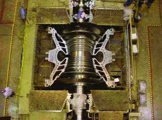

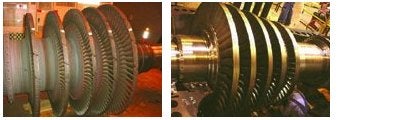

The aforementioned O&M issues also drove Ameren to do wholesale replacements of the turbines of Units 3 and 4. In this case, the goals were to improve unit efficiency and plant output and to lengthen the turbine's maintenance interval (Figure 4). The tandem-compound HP/IP turbine was replaced with a similar low-reaction turbine design (Figures 5 and 6). Replacement of the outer casing was not necessary, which saved capital cost and reduced piping and insulation rework.
4. Bird's eye view. Labadie Unit 3's high-pressure/intermediate-pressure turbine rotor-finishing assembly. Courtesy: AmerenUE
5. You make the call. Compare Labadie Unit 3 and 4's new and old high-pressure (HP) turbines. The old HP section (left) has two fewer rows than the new one (right). Testing found the new design to be 7% more efficient. Courtesy: AmerenUE

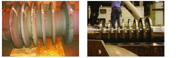

6. Which would you want? On the left is the old intermediate-pressure turbine blade/shroud design of Units 3 and 4. At right is the modern design. Courtesy: AmerenUE

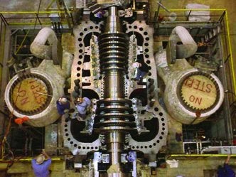

The two double-flow LP turbines with 30-inch L-0 blades were replaced because stress corrosion cracking of the L-1 wheel dovetail area had accelerated enough to warrant either a major repair job or the blades' replacement. After running the numbers, Ameren chose the replacement option, which entailed the use of modern, 34-inch L-0 blades and a smaller blade path (Figure 7). This increased unit capacity by 10 of 14 MW.

7. Almost finished. Lengthening the blades of Unit 3's low-pressure turbine from 30 to 34 inches increased the low-pressure section's efficiency by 5%. Courtesy: AmerenUE
