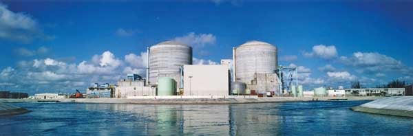

Florida Power & Light Co. (FPL) completed a scheduled refueling and maintenance outage at its St. Lucie Nuclear Power Plant Unit 2 during the fourth quarter of 2007 (Figure 1). But calling it merely a maintenance outage does a disservice to the project team. This was no routine refueling outage. It’s my opinion that this was one of the most ambitious and complex outages ever attempted in the nuclear power industry.
1.    Florida coast fixture. Florida Power & Light’s St. Lucie Unit 2 recently completed a maintenance and refueling outage by replacing two steam generators, a reactor vessel head, and a reactor coolant pump while handling thousands of other work activities. Source: Nuclear Regulatory Commission

St. Lucie Nuclear Power Plant is located on Hutchinson Island, about 8 miles southeast of Fort Pierce, along the east coast of southern Florida. It consists of two 829-MW pressurized water reactors, each featuring a freestanding carbon steel containment vessel with a reinforced concrete shield building forming an annular space between the vessel and shield building. Unit 1 entered commercial service in June 1976; Unit 2 followed in August 1983. Both units’ operating licenses were renewed by the Nuclear Regulatory Commission (NRC) in October 2003. The reactors were provided by Combustion Engineering.

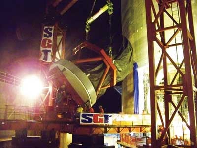

The outage that earned Top Plant recognition began when Unit 2 was taken off-line Sept. 30, 2007, for the 17th refueling outage since it began commercial operation in 1983. More than 16,500 activities were accomplished during the outage. In addition to routine maintenance and the replacement of one-third of the unit’s 217 uranium fuel assemblies in the reactor core, the centerpiece of the outage work package was replacing the two steam generators and the reactor vessel head. Each steam generator is 63 feet tall, 19 feet in diameter, and weighs close to 500 tons. The reactor vessel head might be thought of as the reactor’s "lid," although it is about 8 feet high, 16 feet in diameter, and weighs more than 70 tons (Figure 2).
2.    Off with its head. The old reactor vessel head was removed and then upended as it was extricated from the containment building  Courtesy: SGT
