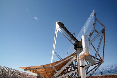

Each SCA is an independently tracking assembly of parabolic trough solar collectors. Every collector includes parabolic reflectors (mirrors), a metal support structure or space frame assembly, a receiver tube, and a tracking system. In contrast to the LS-2 and LS-3 designs used at the SEGS plants, each SCA has a 16.4-ft aperture (like the LS-2) but is 328 ft long (like the LS-3). The mirrors are identical to those used on the LS-2 (Figure 6)
6. Capturing the sun. An organic fluid is heated by solar energy concentrated by the Solargenix solar collector assembly. Courtesy: Arizona Public Service

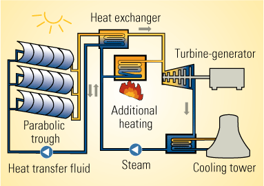

Eight SCAs are pieced together to form each solar collector loop. The ends of the three loops in the solar field are attached to cold and hot HTF headers, which are routed along one side of the solar field to and from the OEC power block. The SCAs rotate around the horizontal north/south axis to track the sun as it moves across the sky over the course of a day. The axis of rotation is located at the collector's center of mass to minimize required tracking power. The drive system uses hydraulic rams to position the collector. A closed-loop tracking system relies on a sun sensor for the precise alignment required to focus the sun on the HCE with a precision of +/- 0.1 degrees.
