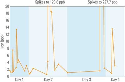

X-ray fluorescence (XRF) also has been developed for online, low-ppb monitoring of iron in feedwater. A study in a nuclear plant found that over 80% of the iron was transported into the unit in less than a two-hour period. XRF analyzes the suspended iron oxides that accumulate on a Millipore filter. The filter pad is changed every few days (Figure 5).
5.    Online corrosion monitoring. This online corrosion products monitoring data, collected by an X-ray fluorescence detector for iron in a supercritical boiler, shows large spikes of iron oxides during plant start-up and cycling loads. The results cover a 65-hour, 42-minute period. Source: Sheppard T. Powell Associates LLC
