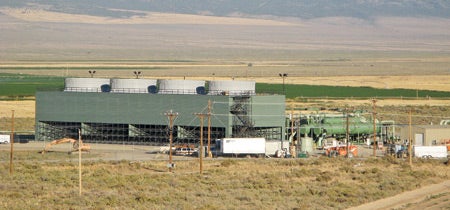

Construction of Raft River Phase One began in June 2006, and Ormat began construction of the OEC in November 2006 (Figure 5). Commercial operation is expected late this year.
5. Raft River rises. The new Raft River geothermal plant’s 13-MW Phase One is scheduled to begin commercial service in late 2007. The original 7-MW DOE demonstration plant only operated for eight months, through mid-1982. Courtesy: U.S. Geothermal
