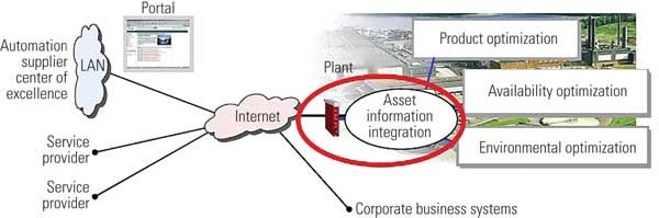

At the heart of the automation system are tools and advanced applications to allow gencos, their experts around the world, and automation suppliers to access information and real-time data from a portal to the automation system, and hence to the entire corporate business system (Figure 4). Thus, a community of experts all with the same objectives can collaborate. Additionally, performance-enhancing products and services can be provided through the portal to increase efficiency and minimize downtime. Clearly, bullet-proof tools for information security, notification management, messaging, and application integration are required.
4. Cutting-edge access. Automation systems must facilitate predictive and condition-based collaborative maintenance management at the plant. Connectivity is provided to other corporate business systems, and information security must be guaranteed. Source: Metso Automation USA Inc.

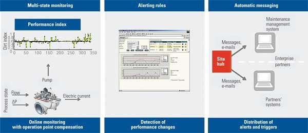

Automation systems must include tools to enable remote proactive maintenance, to monitor and collect data from a system’s network and send notifications to the appropriate center of excellence, where it can be analyzed. Information from any plant device such as pumps, fans, valves, transmitters, electric motors, heat exchangers, boilers and turbine must be collected in real time. Also, quality and cost data are all available for scrutiny by experts anywhere in the world (Figure 5). A good example of how this technology can benefit an individual plant was provided in "Entergy’s Big Catch" in the October 2008 issue of POWER.
5. Future colleagues. Data and information will be transmitted to the automation supplier's center of excellence and to the owner's experts around the world. Enhancing the rate of return on plant assets requires expertise beyond the confines of the plant. Source: Metso Automation USA Inc.
