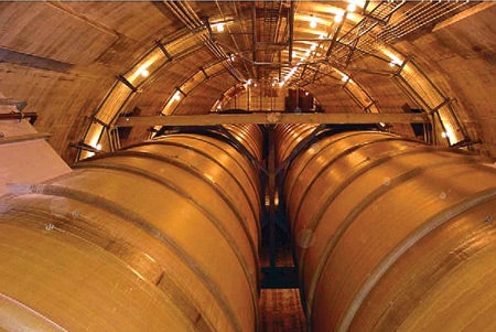

Double stack
P4's new stack is a slip-formed concrete structure that's 430 tall and 67 feet, 7 inches in diameter. Designed by Pullman Power, it took one month of weekdays to erect at the average slip-forming rate of 1 foot per hour. Inside the stack are two fiberglass-reinforced plastic flue gas liners. Each liner is 26 feet, 7 inches in diameter (Figure 7). Both flues were field-fabricated and assembled on site. The resin used on the structural FRP wall was Hetron FR992. A 15-foot-high vertical mandrel was used to spin twelve 30-foot "cans" per flue, which were then placed in the chimney base and jacked into place one at a time.
7. Two in one. The interior of the new, 430-ft tall stack, showing the two fiberglass-reinforced plastic flues, one for each generating unit. Courtesy: Washington Group International
