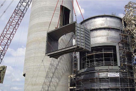

The FGD systems (Figure 3) are designed to remove 95% (30-day rolling average) of the SO2 produced when burning the design fuel. Wheelabrator guarantees that the stoichiometry of the scrubber's limestone reagent will not exceed 1.03 under any conditions. All guarantees are being met with one absorber recycle pump out of service.
3. Scrubbing it down. The inlet to the absorber section of the new scrubber for Unit 1, shown during installation. The system is designed to remove 95% of the unit's SO2 emissions when it's burning coal with a sulfur content of 0.5%. Courtesy: Washington Group International

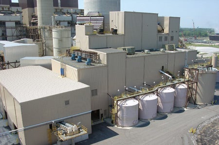

All FGD process systems have been placed in a common building (Figure 4). The reagent preparation equipment is located in the center, between the two absorbers. Adjacent to each absorber is a dedicated primary gypsum dewatering hydroclone. Shared vacuum filter systems and a common storage area have been located at the end of the building.
4. Compact "Scrubber Island." FGD process equipment, limestone preparation, and gypsum dewatering and storage equipment for both units are all housed in a compact design. Courtesy: Washington Group International

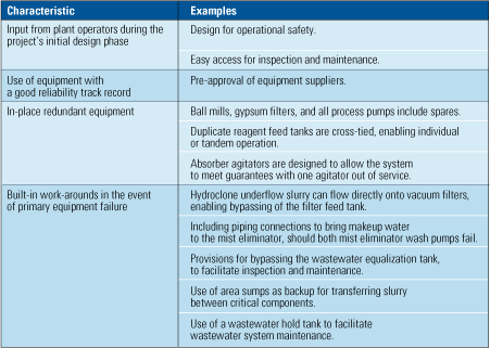

A very interesting aspect of the AQCS upgrade project was its "availability by design" philosophy. To meet such an ambitious goal, Washington Group International and We Energies took a number of specific actions during the design process (see table).
Availability by design. A specific program for maximizing system reliability and availability was developed for the Pleasant Prairie Power Plant project. Source: Washington Group International

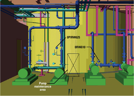

Among them, but not shown in the table, was the development of a 3-D model of the plant to facilitate collaborative design reviews. The 3-D model included all equipment, piping/supports, cable tray, and structural members. Using MicroStation Smart Plant from Intergraph Corp. (www.intergraph.com), Washington Group, We Energies, and subcontractors' site teams took a weekly walk though the design (Figure 5). The software and model enabled interactive reviews of valve and instrument locations, accessibility, egress, maintenance space, hoisting/removal plans, and the like. Without question, building the model was a terrific decision. Time and again it allowed design changes to be proposed, discussed, and finalized with minimal effect on project cost or schedule.
5. Virtual walk-through. Washington Group used 3-D engineering design tools to create a virtual representation of Pleasant Prairie Power Plant. The images were used in performance O&M studies and to identify design deficiencies prior to construction. Courtesy: Washington Group International
