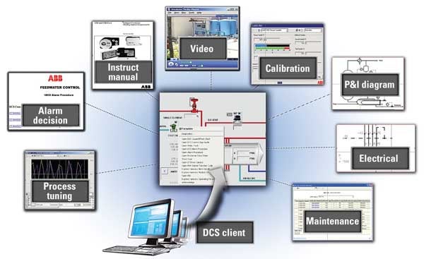

"Aspect links," which are simple, menu-driven links to O&M information, can be launched via mouse click from DCS graphical objects, alarm points, or a controller configuration drawing (Figure 1). Aspect links of interest to plant operators may include alarm decision system information, operational help screens, live video feeds, start-up instructions, and trends. Links of interest to instrumentation and control personnel may include detailed troubleshooting information such as plant piping and instrumentation drawings, equipment O&M manuals, application guides, and smart device management tools. Links used by maintenance management may include work orders, fault reports, or spare part inventories.
1. Linked up. Improving the efficiency of plant operations and maintenance, the 800xA distributed control system (DCS) provides aspect link technology for navigating to important plant information from DCS client screens. Source: ABB
Permissions can be configured to manage individual views into the aspect links, thereby ensuring that system users can only view information relative to their specific job function.

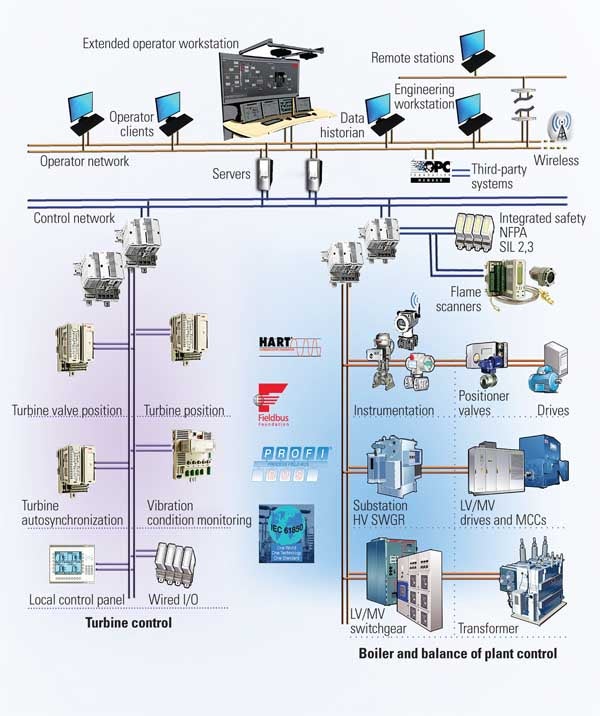

Expanded Connectivity for Process Control. Third-generation DCS controllers and I/O hardware occupy much smaller footprint than earlier systems. DIN rail components operate using 24VDC and can be routed via redundant fiber optic networks. This makes for a more scalable solution, as it is much easier and economical to physically distribute clusters of remote I/O throughout the plant. DCS controller technology has also evolved to support SIL 2 and 3 standards for safety as well as the traditional National Fire Protection Association 85 requirements applied to many utility applications.
Integrated fieldbus is a significant third-generation DCS enhancement. In particular, bussed communication reduces field wiring, and provides beneficial data for asset management. Because the technology allows mixing bus protocol connections within a common controller, it gives plant designers great flexibility for plant layout and final control element device selection. Today’s control systems support the integration of many protocols, including Profibus, Foundation Fieldbus, Device Net, and IEC 61850.
IEC 61850 is a recent development that is used for electrical system integration into the plant DCS. With capabilities of integrating intelligent electrical devices (IED) for control and asset monitoring and device management, the IEC 61850 standard is emerging with connectivity options for protection relays, drives, medium- and high-voltage switchgear, and other equipment. Also, specifically for power plant applications, DCS controllers can integrate field-bussed specialty cards for turbine control (overspeed, auto synch, and valve position), vibration condition monitoring, and flame scanners.
Finally, thought they’re not classified as fieldbus protocols, the highway-addressable remote transducer (HART) and Modbus over Ethernet have also been more tightly integrated into the third-generation DCS controller level (Figure 2).
2. Extended automation DCS. Third-generation distributed control systems offer many options for connecting plant process instruments and devices using fieldbus, Ethernet, and wireless technologies, as well as through traditional hardwired I/O systems. Source: ABB
