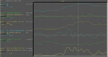

Figure 7 illustrates the results of the load ramp tests conducted during the second night. Start conditions are shown in white and correspond to the white timeline on the far left. Pressure was ramped from 2,000 psig to 1,500 psig at 30 psi/min while varying the number of burners in service. Steam temperatures were effectively maintained within a narrow range. There was a subsequent drop in steam temperatures due to an operator's initial misunderstanding of the inverse relationship of final superheat controller output and the position of spray valves. Later, using manual control, he was able to maintain steam temperature relatively close to the setpoint for the remainder of the load ramp tests.
7. Second-day test results.
The increase in first-stage temperature of approximately 34 degrees F from the full-pressure start condition represents a reduction in temperature variation from 170F to 136F from low load to full load. This yielded a 60% increase in the allowable rate of change of temperature for the 10,000-cycle cyclical life expenditure curve. Source: LCRA
The load was first ramped from 60 MW to 90 MW while pressure was increased from 1,500 psig to 1,650 psig. Then load was ramped to 130 MW at 1,850 psig. The concern was that the combined effect of building load and pressure would cause high steam temperatures. Peak steam temperatures were readily controlled, but a dip did occur following the ramp, indicating a need for further control action. The subsequent load reductions and load increases all resulted in smaller steam temperature variation, due to improved operator control action.
Test results showed an increase in first-stage temperature of about 34 degrees F from the full-pressure start condition. This represents a reduction in temperature variation from 170 degrees to 136 degrees from low load to full load. According to the HP rotor temperature SALI curve, the reduced temperature range provides a 60% increase in the allowable rate of change of temperature for the 10,000-cycle curve (from 280 to 440 F/hr) and an allowable increase in average ramp rate from 7.4 to 14.6 MW/min between 60 MW and 330 MW.
There is a very steep gradient of first-stage temperature at high load. If the maximum load for fast ramping is limited to 315 MW, the range of first-stage temperature change is reduced by 20 degrees F. Applying MSP and this load limit for fast ramping reduces the HP rotor temperature range to 116F for an allowable rate of temperature change of more than 800 degrees F/hr for the 10,000-cycle curve, or an average ramp rate of 29.3 MW/min. In fixed-pressure operation, the 150F variation for a 315-MW maximum load permits a temperature change of 340F/hr, corresponding to a ramp rate of 9.6 MW/min.
During the final load ramp test, load was added at 18 MW/min from 60 MW to 130 MW and then back again. The throttle-pressure setpoint was ramped at 45 psi/min up from 1,500 psig to 1,650 psig, and then to 1,850 psig during the increasing load periods. Pressure was ramped from 1,850 psig to 1,500 psig at 30 psi/minute during the load down-ramping. The pressure ramp rates, which were specified by LCRA engineering, are consistent with the start-up steam drum limitations of 200 degrees/hr for increasing temperature and 150 degrees/hr for decreasing temperature. The total range of superheat temperature variation was 977F to 1,008F while load varied from 59 MW to 131 MW and pressure varied from 1,488 psig to 1,858 psig.

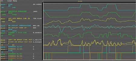

There was no explicit testing conducted at high load. However, the unit was ramped from low load to full load during the afternoon of October 28. As the unit was ramped at 18 MW/min, the steam temperature increased to 1,025F with the spray valves full open. The load ramp was stopped until the steam temperature dropped to an acceptable value, and then continued. Figure 8 shows the next set of trend lines, 20 minutes later. A load of 315 MW was reached at 12:51:32, or 20 minutes after the start of the ramp, as indicated by the white timeline.
8. Fast load ramp. A load of 315 MW was reached in 20 minutes as part of a load ramp test, as indicated by the white timeline. Source: LCRA
The first-stage metal temperature reached 918.2F at 12:51:32, representing a 150-degree temperature rise in 20 minutes, or 450F/hr. Based on the SALI curve, this corresponds to a CLE of 0.02%, or a 5,000-cycle curve. Although the unit was ramped at 18 MW/min at times, the average ramp rate was 11.25 MW/min. The slow temperature response of the first stage produced a lower-than-normal temperature for the 90-MW condition at the start of the fast load ramp. This contributed to the large first-stage metal temperature change.
These data indicate that the 18 MW/min ramp rate may exceed the allowable CLE 10,000-cycle curve if load is ramped from low load to nearly full load. If steam temperatures had not limited the load ramp, it is likely that a faster rate of temperature change would have produced even greater cyclic life expenditure.
With MSP in place, the temperature variation would have been approximately 120 degrees instead of 150 degrees, due to a higher first-stage metal temperature at low load. The 10,000-cycle curve allows an 800F/hr rate change for operation, which corresponds to an allowable 25 MW/min ramp rate.
Achieving these fast ramp rates with MSP depends on the ability to control steam temperatures. In this test, steam temperatures reached 1,025F with tilts low and superheat sprays at maximum. Because gas header pressure was high, it is unlikely that burners could have been turned off. Another control variable would have to have been used to lower transient temperature.
