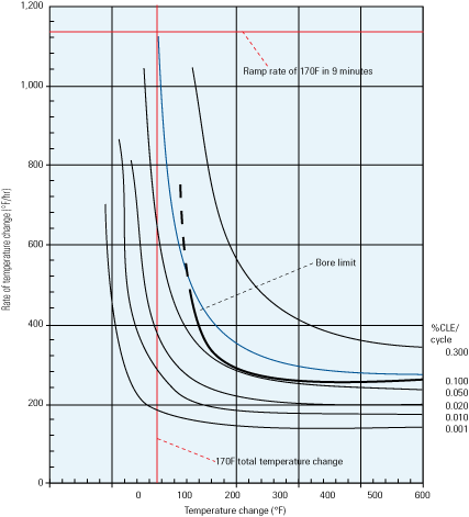

Sim Gideon engineers then developed a test plan for investigating the ability of control methodologies to increase unit ramp rate while maintaining the rate of HP turbine metal temperature change within acceptable limits. The unit ramp rate is currently limited by HP turbine rotor CLE considerations, as determined by the turbine vendor's starting and loading instructions (SALI) curves (Figure 2).
2. Limiting factor. Unit ramp rate is limited by the high-pressure turbine rotor's cyclic life expenditure. Source: LCRA
The asymptotic shape of the SALI curves suggests that a small decrease in total HP rotor temperature change provides a large potential increase in the allowable rate of change of temperature for the same CLE. If the total HP rotor temperature change could be reduced from the current maximum of 170F to a range of 115F to 135F, the ramp rate could be maintained at a higher value without exceeding the desired CLE.

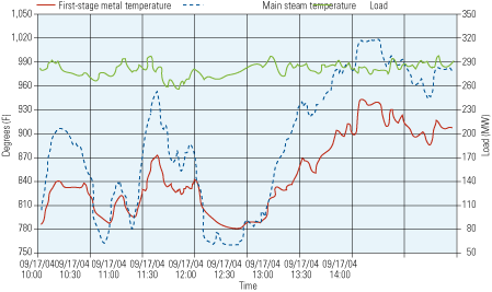

Temperature changes in the HP rotor cause the stress expressed as CLE by the turbine vendor. Each temperature cycle consumes a percentage of cyclic life. LCRA would like to operate on the unit's 10,000-cycle curve, which corresponds to the 0.01% CLE/cycle curve in Figure 2. The red vertical line at 170F corresponds to the maximum HP rotor temperature change from minimum load to full load. To remain within the 10,000-cycle curve, the rate of temperature change should not exceed 280 degrees F/hr. The dispatch rate and load end points dictate both the change in HP rotor temperature and the rate of change of temperature. Figure 3 presents first-stage and superheat temperature data during typical load dispatch operation.
3. One day at a time. Load, turbine first-stage temperature, and superheat temperature during dispatch of Sim Gideon Unit 3 on a typical day. Source: LCRA
