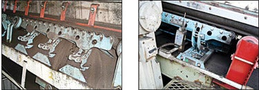

Just as containment is crucial to fuel handling, housekeeping is fundamental in preventing coal fires and explosions. At Monticello, housekeeping across all active parts of the fuel-handling system—beginning at train-receiving tunnels and continuing through tripper and crusher houses and conveyor belts—is a daily duty. Equipment is shut down to allow effective cleanup and washdowns. Entire structures are washed down less frequently (usually weekly) with the help of contract labor.
Personnel who work in fuel-handling areas understand that housekeeping is everyone's responsibility. They clean up spills when they find them, investigate to find the sources, make repairs themselves or write work requests, and follow up on the repair process. As a result, Monticello is noticeably cleaner than it used to be (Figure 4).
4. Classic before and after. Shown on the left is part of the fuel-handling system that had been upgraded before housekeeping was made a higher priority. At right is the same area today, at a much higher level of cleanliness. Courtesy: TXU Power
