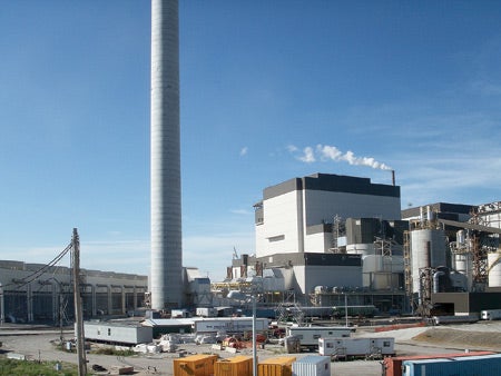

When it selected an air quality control system, WSEC Unit 4 checked every box on the dealer's list of options (Table 2). The unit incorporates state-of-the-art pollution controls (Figure 5) to keep NOx, SO2, and particulates in check.

5. All the add-ons. Air quality control systems include a selective catalytic reduction unit, three spray dryer-absorbers, a pulse-jet filter train, and a tall stack. Courtesy: Hitachi America Ltd.

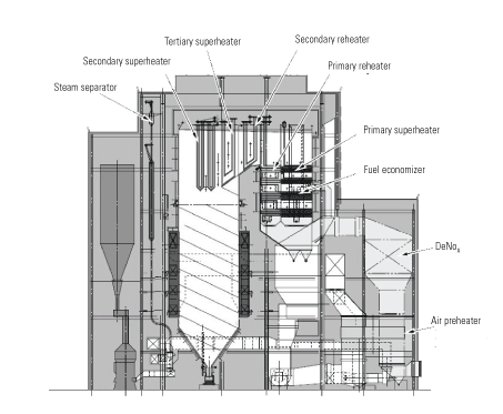

Hitachi supplied the selective catalytic reduction (SCR) system that reduces NOx emissions immediately downstream of the boiler (Figure 6). The PRB coal contains high calcium and high catalyst poisons, and the dust easily sticks to the catalyst. This SCR system uses a Hitachi plate-type catalyst that has a higher resistance to dust plugging and has been modified to achieve higher durability in PRB-fired flue gas. The catalyst reactor is compact, with special flue-gas mixers upstream of the reactors. This mixer accelerates NH3 mixing with flue gas during a short residence time using the U2A system from Wahlco Inc. (www.wahlco.com). In this process, the urea is diluted to a 40% urea/water solution, which then is hydrolyzed into NH3.
6. Take a slice. A cross-section view of WSEC Unit 4's boiler and other major components. Sliding-pressure operation improves plant efficiency at partial loads. Source: Hitachi America Ltd.
