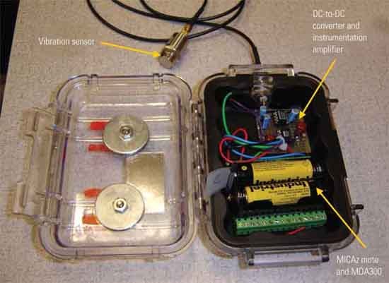

The Type-2 vibration-sensing node was designed using an external vibration probe with a magnetic holder that could be attached to locations where the Type-1 vibration-sensing node enclosure would not fit (Figure 5).
5. Vibration sleuth.
The Type-2 vibration sensor is equipped with an external sensor, a custom sensor interface board, and a high-speed sampling mote. Courtesy: Southern Co.
This node was equipped with the following components:
  • External vibration sensor. An external piezoelectric device originally used with a commercial, handheld vibration meter.
  • Custom sensor interface board. Piezoelectric sensors are high-impedance devices, and they must be interfaced with signal-conditioning circuits that have high input impedance. A custom interface board was designed to match the high impedance of the sensor and transform the vibration signal to appropriate voltage variations for the data acquisition board.
  • High-speed sampling mote. The data acquisition board performed two functions. First, it was used to generate the DC power to activate the interface board at intervals of 15 minutes, when vibration samples were taken. Second, during the sampling period, it obtained 20 samples at intervals of 50 ms for obtaining the vibration intensity.
