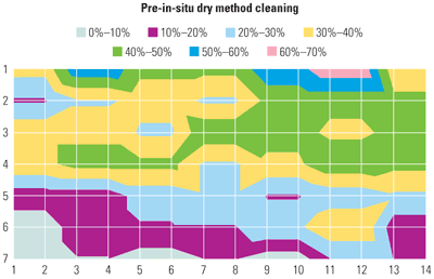

The dry method of cleaning typically involves a combination of vacuuming and air lancing to remove the ash from the reactor; in gas applications, it also may include removal of insulation debris and/or rust scale. This process is typically very effective where the modules have flyash buildup but no LPA in the catalyst. This can be performed in situ or off-site, depending on site logistics and outage considerations (Figure 6).
6. Dry cleaner. Dry cleaning using vacuuming/air lancing can reduce catalyst fouling due to buildup of large-particle ash and ash fines. The example below shows reduction from 30% to 50% on average. Courtesy: Cormetech Inc.

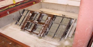

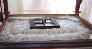

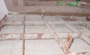

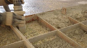

Wet cleaning of severe ash buildup on a catalyst cleaning is referred to as washing, regeneration, or rejuvenation (Figure 7), depending upon the process and aqueous solution used. This is a more elaborate cleaning process that removes most of the chemical buildup on the catalyst surface. The process generally restores the catalyst activity lost to both gross and fine physical blockage. In addition, the process can be used to restore all or a portion of the catalytic activity lost due to chemical poisons.
a. Removal of ash
b. Vacuuming
c. Washing using a cleansing solution
d. Bubbling and aeration under pressure
 7. Rejuvenation. These images depict some of the stages in SCR cleaning using the rejuvenation process.
