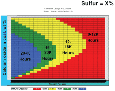

Analyze the data
Variations in fuel characteristics can have a considerable impact on catalyst life. The nature of the fuel fired (be it Powder River Basin or eastern bituminous coal, petcoke, or blends of both) will dictate in large part the rate of catalyst deactivation. Historical data and know-how are key to an accurate assessment of what to expect in the future. Analytic tools such as the one shown in Figure 3 are invaluable in assessing a fuel's impact on a catalyst's long-term effectiveness.

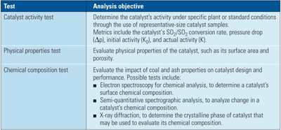

Ways to measure catalytic activity/potential
Source: Cormetech Inc.
3. FIELD guide. This is an example of a fuel impact evaluation and life determination (FIELD) guide for SCR catalysts.
Once catalyst testing and data evaluation are complete, the catalyst's activity potential is assessed in combination with field data and the future operating considerations described in the previous section; the goal here is to determine the available catalyst-management options. Figure 4 is an example of a catalyst management plan that can take into account a wide range of influences on catalyst management decisions.

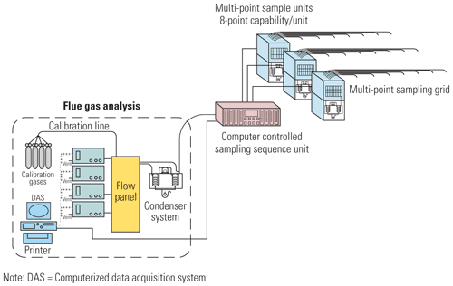

The purpose of ammonia injection grid (AIG) tuning is to ensure an even ammonia-NOx molar ratio distribution to the catalyst. Contrary to popular belief, the goal of doing so is not necessarily to get the outlet NOx profile flat; this is possible only when the inlet profile is flat. If the inlet profile is skewed, there are generally two options:
  • Tune the AIG to match the inlet distribution over the load range. In this case, the outlet NOx profile will not necessarily be flat.
  • Attempt to flatten the distribution through mixing technology.
The level of AIG tuning will depend upon the system design and operational methodology. Proper AIG tuning/NH3:NOx distribution ensures maximum system efficiency and reduced ammonia slip and can effectively extend catalyst life. The process also eliminates localized regions of high ammonia slip, which can lead to air preheater fouling when combined with SO3.
Specific tests can be conducted to facilitate tuning the AIG until it is operating at peak performance. Periodic checking and optimization of the ammonia-to-NOx distribution are essential for ensuring the long-term optimal performance of an SCR system. The frequency of tuning is dictated by unit-specific conditions, including NOx distribution from the boiler and the style of AIG/mixer system in use. In general, it is worthwhile to check the distribution annually. Figure 5 shows a multipoint sampling system capable of efficiently and accurately performing AIG tuning.
5. Tune-up tool. This multipoint automated sampling system (MASS) is used for ammonia injection grid tuning. Source: Clean Air Engineering
