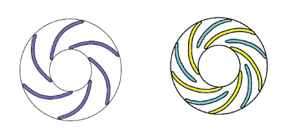

It was accepted practice in pump-turbine design that increasing the number of blades (or runners) would increase frictional losses and reduce unit efficiency. However, recent computational fluid dynamics (CFD) analyses have revealed that in runners, turbulence losses are far greater than frictional losses. The analyses also found that increasing the number of blades reduces turbulent loss and dramatically increases turbine efficiency (Figure 5).
5. Traditional vs. innovative. A conventional runner design found on typical vertical pumps (L), compared with a splitter runner design, in which multi-blade runners consisting of long and short blades are arranged in turn. Source: Tokyo Electric Power Company Inc.

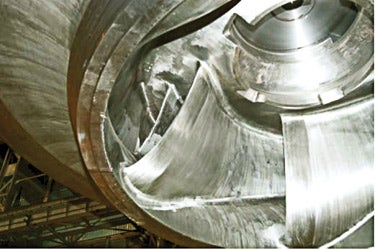

However, in the past, increasing the number of blades narrowed flow paths and prevented runners from discharging enough water to allow turbines to produce large outputs (even at high flow rates). TEPCO overcame this problem by fitting runners with both long and short blades. As a result, the company was the first in the world to develop and deploy pump-turbines with splitter runners (Figure 6).
6. Freshly machined. The splitter runner design in detail—long blade (front) and the short blade (back). Courtesy: Tokyo Electric Power Company Inc. All rights reserved.

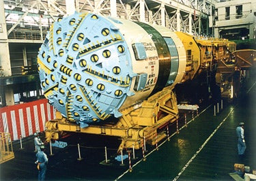

TEPCO matched its innovation in runner design by applying some novel techniques to the construction of Kannagawa's underground water infrastructure. In the pumped-storage world, it is common practice to connect two reservoirs by first drilling a small pilot tunnel from the bottom reservoir up, and then drilling and enlarging the tunnel from the top down. To avoid this long and laborious process, TEPCO used a "full-face tunnel boring machine" (TBM) to drill the penstock tunnel (which is inclined 48 degrees, approximately 20 ft in diameter, and more than 3,000 feet long) in one fell swoop, from the bottom to the top.
The TBM (Figure 7), weighing in at 600 tons, is self-supporting, so it doesn't slide down the steep incline. It also is equipped with a boring machine to survey soil up to 100 ft ahead. Ultimately, the TBM shortened the time needed to drill the penstock tunnel by about six months. Drilling through sold rock, it worked at an average speed of 225 ft/month.
7. Boring holes. Construction of the 3,000-foot long penstock tunnel marked the first use of a tunnel boring machine in Japan. Courtesy: Tokyo Electric Power Company Inc. All rights reserved.
