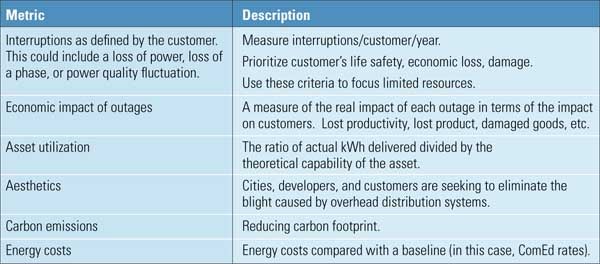

The first step in developing any quality program is to develop a methodology to collect discrete statistics from which to measure progress and determine a set of desired end-state metrics (Table 1). The IIT team participated in two training courses on Six Sigma quality methods and principals at the Joseph M. Juran Center for Leadership in Quality at the University of Minnesota, Carlson School of Management. The purpose of this training was to develop a replicable methodology for creating PPS. The team subsequently adopted the following standard quality methods for the project:
  • Determine what is critical to quality (CTQ) from the customer’s perspective.
  • Process map CTQ elements and develop measures that quantify performance or the cost of poor quality.
  • Perform a Failure Modes and Effects Analysis (FMEA) for each process step.
  • Engage in error proofing, innovative problem solving, and solution set generation.
  • Prioritize the implementation steps.
    Table 1. Energy system quality metrics. The Perfect Power System team began by defining IIT’s power quality needs and a set of desired end-state metrics. Source: IIT
