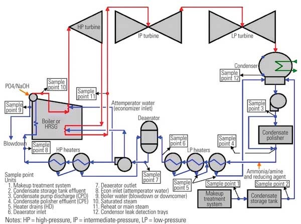

Most coal-fired plants monitor and control the oxidizing environment at two or three locations, typically at the condensate pump discharge, deaerator inlet and outlet, and economizer inlet (Figure 2). Combined-cycle plants usually monitor and control the oxidizing environment at just two locations: the condensate pump discharge (usually after chemical feed) and the deaerator or low-pressure (LP) drum outlet. The sample locations themselves might be appropriate, but the AT ORP sampling should be made as close as possible to the actual sample take-off point.
2.     Popular sample points. These are typical steam cycle water and steam sample point locations. Source: Nalco

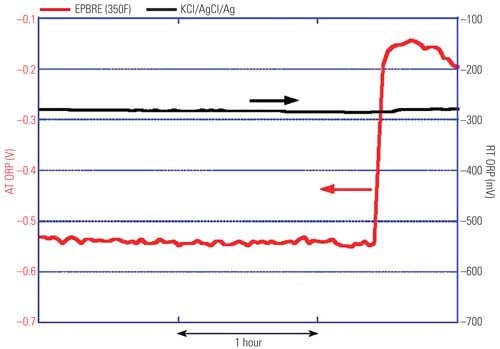

Figure 3 illustrates the impact of reductant feed on both RT ORP and AT ORP. Reductant was added to a solution initially containing 140 ppb DO. More reductant was added over time, and DO declined. The range of ORP movement increases significantly with the AT ORP measurement. The AT ORP probe is more responsive to changes in DO and/or reductant. This increased sensitivity has important implications for system control based on an ORP setpoint. Greater sensitivity provides better response to changes in the corrosion environment. RT ORP probes are completely insensitive to some of the macro corrosion changes occurring at temperature.
3.    Some like it hot. The at-temperature oxidation-reduction potential (ORP) probe, with water samples at operating temperatures and pressures, produces superior results. Source: Nalco

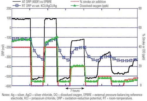

Carefully Measure Dissolved Oxygen. RT ORP can correlate with DO, but it tends to be a poorer indicator of reductant excess in boiler feedwater systems. However, even as a DO "indicator," the AT ORP probe response and magnitude of movement to DO upsets is far superior to that of RT ORP.
Figure 4 presents laboratory data showing ORP response as measured after making short-term changes in DO concentration in a system. The immediate, relative, and greater magnitude of the AT ORP response is evident. It’s especially important to note the resolution of the AT ORP response at extremely low (<10 ppb) DO concentrations. RT ORP response is especially poor at low dissolved oxygen concentrations, yet this is the very zone where power plants typically operate.
4.    At-temperature measurements are more responsive.
Note the difference between at-temperature (AT) ORP and room temperature (RT) ORP response to adding various amounts of air-saturated water at 400F. Source: Nalco
