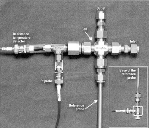

AT ORP enables in-situ measurement of ORP in feedwater at the elevated temperatures where sensing electrodes are actually in contact with high-temperature water. Traditional ORP measurements utilize a nonrepresentative sample (cooled feedwater) that moves through long sample lines (increasing lag time) to a non-optimum device (RT ORP). AT ORP takes a representative sample (hot feedwater) to a much more sensitive device (Figure 1).
1.    At-temperature oxidation-reduction potential (AT ORP) measurement. These are the components of Nalco’s AT ORP cell. Courtesy: Nalco
The Nalco Co.’s AT ORP assembly consists of a sample inlet and outlet, connections for an integral resistance temperature detector (RTD), platinum electrode, and a separate external pressure-balanced reference electrode (EPBRE). This apparatus has been used in high-temperature water environments up to 500F and 3,000 psi (20.68 MPa).
The potentials measured by the AT ORP platinum probe are measured against the external, pressure-balanced, silver/silver chloride reference electrode. The temperature of the water flowing through the probe is recorded. All of the data collected by the probe can be archived and recovered on the plant data-logging system with suitable electrical signal conditioning. The signals can be used to control any species affecting the ORP space (typically reductant feed) and for advanced diagnostics.
