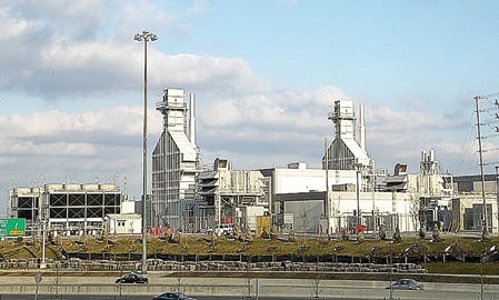

After deregulation in the summer of 2002, and especially after the blackout a year later, GTAA wasted no time reviving its plan to build a cogen plant. Executives envisioned the benefits of such a plant going beyond making the airport self-sufficient in energy. Any excess production could be sold on the open wholesale market, increasing the supply on the provincial grid and helping the IESO cope with rising demand. The twin rationales made economic sense, so this time the cogen project went forward and was completed. Named the GTAA Cogeneration Complex (Figure 1), it was the first of the aforementioned wave of gas-powered power projects to come on-line following Ontario’s adoption of its “off-coal transition plan.”
1. Quick response. The GTAA Cogeneration Complex broke ground 11 months after the northeast U.S. and Ontario blackout of August 2003 and was commissioned 19 months later. Courtesy: GTAA

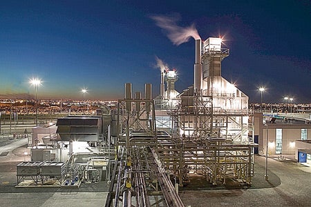

The GTAA Cogeneration Complex uses a common 2 x 1 combined-cycle configuration (Figure 2). Two 42-MW GE LM6000PD gas turbines exhaust into separate, dual-pressure, once-through heat-recovery steam generators (OTSGs) from Innovative Steam Technologies Inc. (IST, www.ostg.com). The outputs of the OTSGs are combined to feed a single 33-MW Demag Delaval ST4-CE300-L steam turbine from Siemens (www.powergeneration.siemens.com). The plant layout includes space for the future installation of selective catalytic reduction (SCR) systems for additional control of NOx emissions. SCR systems are not needed today because both gas turbines are equipped with dry low-NOx burners.
2. No drums, please. The 117-MW combined-cycle plant is configured 2 x 1, with two LM6000PD gas turbines from GE, two once-through heat-recovery steam generators from Innovative Steam Technologies, and one Demag Delaval steam turbine. Courtesy: GTAA
