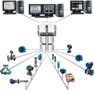

The additional wealth of data from field sensors, actuators, and diagnostic equipment leads to another significant development: plantwide asset management systems as an integral component of the DCS architecture. This plantwide asset management concept goes beyond the traditional DCS status alarm concept and allows for detailed and coordinated analysis of plant assets and operations permitting proactive, not just reactive, response to plant conditions (Figure 4).
4. Emerging trends. DCS technology will continue to evolve in response to technology advances such as integrated simulation, high-performance digital bus architecture, wireless applications, cyber-security concerns, and more-capable and robust software applications. Source: Emerson Power & Water Solutions
