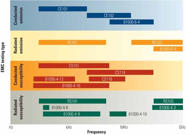

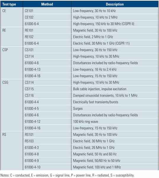

The types of EMI/RFI tests and their applicable testing methods are shown in Table 4. The descriptions are the same as those given in RG-1.180; therefore, the frequency limits given are the endorsed limits and not necessarily the limits of the standard listed. The standards are grouped by whether they are for conducted or radiated tests, emission or susceptibility tests, and (for conducted susceptibility) power or signal line tests. An illustration of the frequency ranges as they appear in the table for the different standards is shown in Figure 1.
Table 4. EMI/RFI tests, applicable methods, and method descriptions. Source: Analysis and Measurement Services Corp.
1. EMC testing standards endorsed by Regulatory Guide 1.180 and their associated frequency ranges. Source: Analysis and Measurement Services Corp.
Depending on the needs and characteristics of the I&C system under consideration, a suite of EMC tests is determined that will be required to satisfy the NRC requirements. Although there are several different sources for the testing standards, it should be noted that the testing methods are mutually exclusive and cannot be mixed and matched. Methods from multiple standards sources cannot be mixed to provide full testing coverage; one standard must be applied in its entirety. RG-1.180 also provides the option of applying alternative test suites from the most recent versions of the MIL-STD and IEC guidelines.
