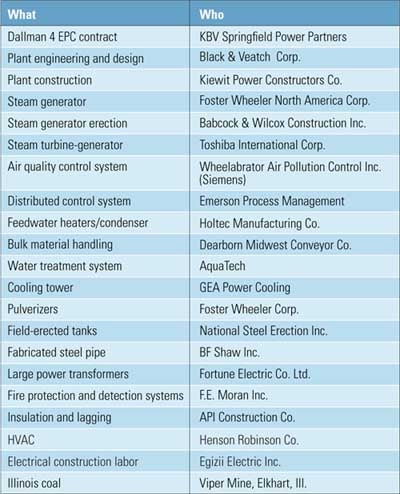

Other major contractors and equipment suppliers are listed in Table 3.
Table 3.    Major contractors and equipment suppliers to CWLP Dallman Unit 4. Source: CWLP
