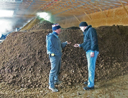

Anaerobic digesters also solve another problem: manure management. Manure can be processed through a mechanical separator, and then the solids can be dried and used to replace sawdust or sand as bedding for the animals, because pathogens are killed during digestion. That use alone saves $80,000 to $150,000 annually for participating farms. Any solids not used for bedding may be further processed and sold to the public or garden centers as a soil amendment or garden compost, providing an additional revenue stream. Taken together, these are enormous benefits in a state with a major farm economy (Figure 3).
3. Recycling solids. Earl Audet (left) and David Dunn examine some of the dry solids left over from the manure digestion process at Blue Spruce Farm. The solids, which resemble peat moss, are used as bedding for the cows, saving over $100,000 annually on sawdust. Courtesy: CVPS
