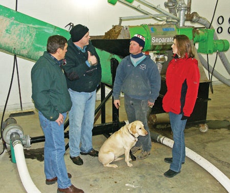

1. Tanks for the manure. Steve Dvorak (far left), who designed the digester at Blue Spruce Farm, Dave Dunn, Earl Audet (with Sierra at his feet), and Melissa Dvorak discuss the separation process, which divides liquids from solids after the manure spends 21 days in the digester. Courtesy: CVPS

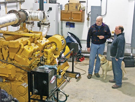

The gaseous engine fuel comes from manure and other farm waste held in a sealed concrete tank at the same temperature as a cow’s stomach (approximately 101F) for about 21 days. Bacteria digest the volatile components, creating methane while killing pathogens and weed seeds. The methane is then piped to a modified, naturally aspirated engine-generator (Figure 2).
2. Low-Btu gas. David Dunn, CVPS Cow Power coordinator (left), and Ernie Audet discuss generator operation at the Blue Spruce Farm in Bridport, Vt. Audet and his brothers own the farm, the first to begin producing CVPS Cow Power. Four farms are now part of the program. Courtesy: CVPS
