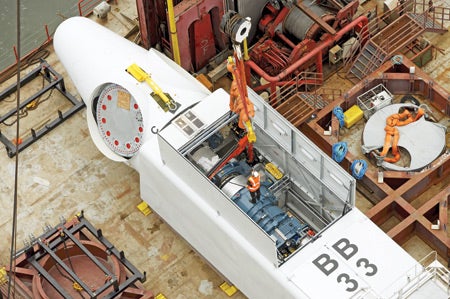

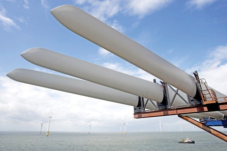

Each wind turbine assembly consists of the turbine, blades, and nacelle; a support tower; and a foundation. Each turbine is configured with a 350-foot-diameter three-bladed rotor with blades 172 feet long (Figure 2). The rotor assembly is connected directly to the gearbox and generator contained in the nacelle and mounted on top of a 210-ft tower (Figure 3). Each tower supporting a turbine is anchored to the seabed by a foundation consisting of a single monopile structure over 16 ft in diameter and over 170 ft tall. The foundation is driven up to 80 ft into the seabed such that it extends 56 ft above mean sea level. The turbines are spaced between 1,750 and 2,400 ft apart.
2. A tale of three blades. Siemens uses a three-bladed turbine design. Each blade is over 170 feet long and is connected to the turbine hub at sea. Courtesy: Siemens Power Generation
3. Mini power plant. The turbine nacelle houses the gearbox, generator, and controls and was preassembled onshore. The entire assembly was then lifted and attached on top of a 210-foot support tower. Courtesy: Siemens Power Generation

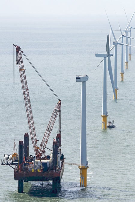

At Mostyn, the 210-ft steel support towers were preassembled with all the internal and electrical systems and then tested. Purpose-built vessels were used to ferry the towers, nacelles, hubs, and blades to the site, about 4 miles offshore. Each of the turbines required five heavy lifts spaced over half a day. Some lifts were up to 185 tons. Erection of all 25 turbines was completed in only 43 days (Figure 4).
4. Float like a butterfly. A specially built floating crane was used to lift the nacelle, hub, and blades into place. Note that the nacelle is in place and the crane is in the process of lifting one of the three blades. Courtesy: Siemens Power Generation
