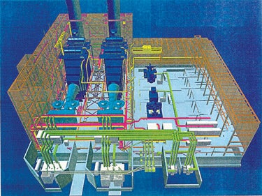

Purchasing replacement tube assemblies may have been the easiest part of the project. BNYC is fully enclosed in a 12-story building (with no elevator) and surrounded by narrow streets and other buildings, making delivery and installation a logistical nightmare. Delivery of replacement harps for the HRSG had to be completed at night to reduce traffic snarls. Two cranes, a hole cut in the roof, and around-the-clock work by trades and plant staff kept the project on schedule (Figure 4). Two years later, BNYC continues to operate efficiently with no recurrence of any of the problems that plagued Mission Energy.
 4. Close quarters. Replacing the HRSGs was a challenge for the land-locked, 12-story building enclosing the power plant. Courtesy: Delta Power Co.

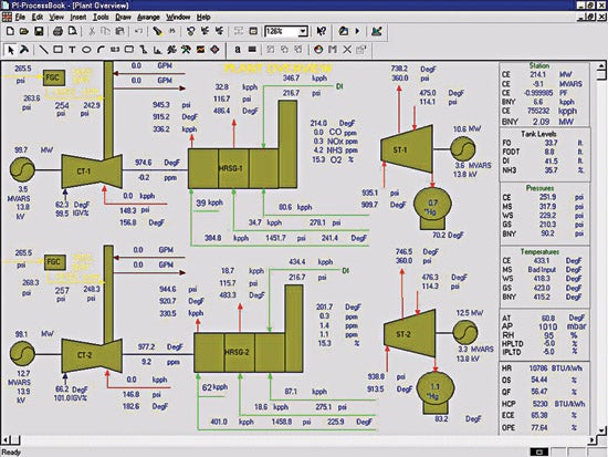

Gas turbine controls were also upgraded with a Siemens XP-based Teleperm system. The plant controls, based on the Bailey Infi 90 (Figure 5), were upgraded with new operator interface screens. The UPS system was upgraded by configuring two existing UPS units to share critical bus load and by adding a new backup unit.
5. Processing data. A Bailey Controls Infi 90 DCS interfaces with a PI server to control the plant. Courtesy: Delta Power Co
