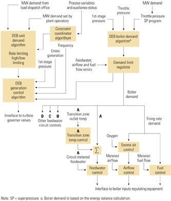

The updated DEB system for Eddystone (Figure 1) decouples generation control (turbine output) from boiler control. Generation control makes maximum use of stored energy to balance turbine output with AGC demand. Unlike conventional coordinated control, in which an arbitrary feed-forward rate is used to overfire or underfire the boiler, the new DEB system calculates in real time stored energy requirements plus load change and applies that to the control of firing rate. The concept thus maximizes use of the once-through boiler's stored energy.
1. Separating generation and boiler control.
The direct energy balance (DEB) control strategy at Eddystone Generating Station was updated as part of modernizing the plant's distributed control system. Source: Metso Automation
Generation control includes a triple-cascade control loop with the following input parameters: megawatt output, turbine first-stage pressure, frequency, and aggregate governor valve position. This provides a linear megawatt response at maximum rate.
Two special algorithms allow for maximum rate of change at all times:
  • A constraint coordinator ensures that all critical variables—including steam temperature, waterwall metal temperatures, and feedwater flows—are kept within allowable limits as the rate change is being implemented. When the rate of change is at the maximum level, operators don't have to worry about exceeding any process limits. Mechanical and electrical limits on fan dampers, feeders, spray injection valves, boiler feedpumps, and turbine valves also are monitored and "constrained."
  • A demand limit regulator monitors various process errors, including airflow, fuel flow, and feedwater flows. During a load ramp, if any of these parameters is exceeded, boiler demand is reduced to a point that supports the limited parameter.
