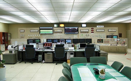

4. Familiar controls. The standardized plant design also allows operators to quickly become proficient with operating any of the units at the Boryeong plant or at other plants that follow the standardized plant design. Courtesy: KOMIPO
