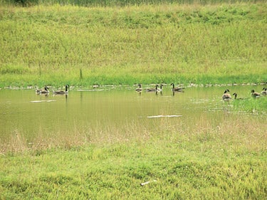

Satisfying the New York DEC would take far more than that, however. For example, as a condition of obtaining a permit for the plant, PSEG had to do some significant environmental remediation. The company had to create 1.5 acres of new wetlands for every acre displaced by the new infrastructure of the riverside plant. (Relatively, that wasn't much of an imposition; the nearby Athens Generating Plant that went on-line in 2004 had to remediate wetlands at a 5:1 ratio.)
Given the site's number of overhead power lines and underground gas lines, building the new wetlands was a bit of a tight squeeze. But PSEG turned the trick. It set up an estuary and planted indigenous trees, shrubs, and plants of the right species to maintain botanical diversity (Figure 3). The company even stocked ponds with "mosquito fish" (Gambusia affinis), known for their appetite for mosquito larvae.
3. Quacking the code. To obtain a permit for the repowering project, PSEG had to create one and a half acres of wetlands for every acre taken away by construction of the new plant. Courtesy: PSEG Power

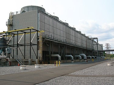

Another aesthetics hoop that PSEG was asked to jump through involved the visible vapor plumes generated by the new plant's wet/dry cooling towers. The company found that the incidence of "blue plumes" could be reduced by 75% (compared with a wet tower) by installing louvers halfway up the towers (Figure 4). When the dew point hits a certain level, the louvers open automatically, releasing from the side of the tower a considerable volume of air that otherwise would have reached the top. At dew point plus several degrees, a certain amount of steam vented to atmosphere will travel only a short distance before disappearing. The part of the steam that is latent heat remains visible, but not the part that is water vapor.
4. Now you see it . . . Triggered by dew point, louvers halfway up the cooling tower bank open automatically to reduce Bethlehem Energy Center's emissions of "blue plumes." Courtesy: PSEG Power
