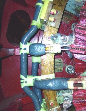

The final step of the assembly process was to install the phase rings at the NDE of the stator by securing them to the brackets (Figure 6). Connections then were made to the existing phase bars by means of parallel copper plates brazed to either side of the phase ring ends and soldered to the phase bar strands.
6. Holding on. Brackets for mounting the phase rings were installed on the outside of the outer support ring structure. Courtesy: Alstom Power
