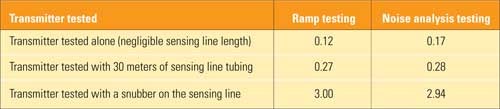

The validity of the noise analysis technique for online detection of sensing line blockages has been established by numerous laboratory and in-plant demonstration tests involving a variety of pressure transmitters. (See H.M. Hashemian, "Long-Term Performance and Aging Characteristics of Nuclear Plant Pressure Transmitters," U.S. Nuclear Regulatory Commission, NUREG/CR-5851 [March 1993]). Table 2 shows representative results of such tests that involved a Barton pressure transmitter. The transmitter was tested alone, then with 30 meters of sensing line tubing, and finally with a snubber in the sensing line. In each case, the response time of the transmitter and the attached sensing line was measured by the conventional ramp method and by the noise analysis technique. The noise was generated for this experiment in a laboratory test loop that was designed to simulate process fluctuations for research purposes.
As shown by these results, the noise analysis technique identifies the response time of the transmitter and its sensing line with good accuracy and accounts for the effect of sensing line length and the blockage (simulated by the snubbers) on the response time.
Table 2. Representative results of validation of noise analysis technique for response time testing of pressure transmitters and associated sensing lines. Source: Analysis and Measurement Services Corp.
