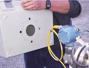

In the event that an instrument is located too far from the assigned segment protector, construction can add an additional segment protector daisy-chained to take full advantage of the Foundation Fieldbus available trunk line length limits rather than change the way the instruments are assigned in the DCS (Figure 5).
5.    Plan ahead. A typical level transmitter is shown with excess prefabricated cable coil. The excess cable is due to using precut lengths with shop-installed connectors to ease installation. Courtesy: Fluor
