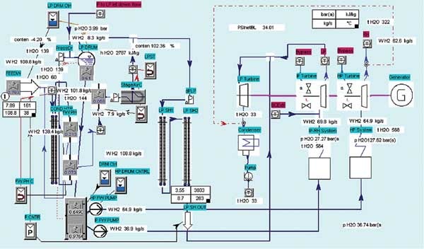

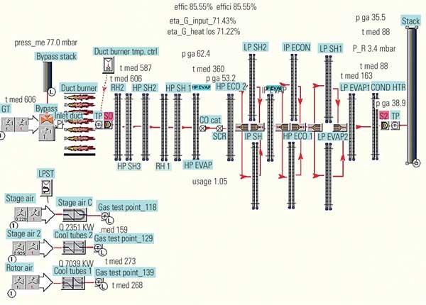

To simplify the modeling process, the gas-side (Figure 1) and water-side (Figure 2) streams are laid out separately while sharing the same components. Initially, the model is constructed using OEM design data. Running this "clean" model should yield results that closely match those specified in the OEM design cases. The "clean" model can then be adapted to investigate various operations and maintenance (O&M) issues, as shown in the following examples taken from recent projects at a number of power plants.
1. Triple play. This is an example of a gas path model for triple-pressure reheat HRSG. Courtesy: Tetra Engineering Europe
2. Following the flow. This is an example of a water path model for triple-pressure reheat HRSG. Courtesy: Tetra Engineering Europe
