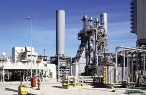

Today, gas-fired plants (Figure 3) account for almost 50% of Turkey’s electricity generation, while hard coal and lignite fuel 21% of power production, according to MENR estimates.
3. Gas fuels half. Natural gas fuels nearly half of the power generated in Turkey. The Adana Combined Cycle plant uses a General Electric Frame 6 gas turbine. Courtesy: Enerjisa

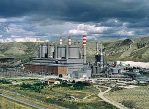

5. Fueled by Turkish lignite. The lignite-fired Cayirhan Power Plant, located in Ankara, has four units, 2 x 150 MW and 2 x 160 MW. Courtesy: Türkiye Müteahhitler Birligi
Unfortunately, Turkey does not have a good record when it comes to lignite-fired generation. The country’s biggest plant is the pulverized coal – firing 2,800-MW Afsin Elbistan plant in southeast Turkey (Figure 6). Unit A began operating in 1983 and Unit B in 2006. Unit A has attracted criticism as none of its flue stacks has a desulphurization unit, while its electrostatic precipitator system cannot handle the amounts of coal required when the plant is firing at full capacity. Furthermore, there is no fly ash dam facility at the plant, and the ash is stacked in an open dump, where it can be blown into surrounding areas by strong winds.
