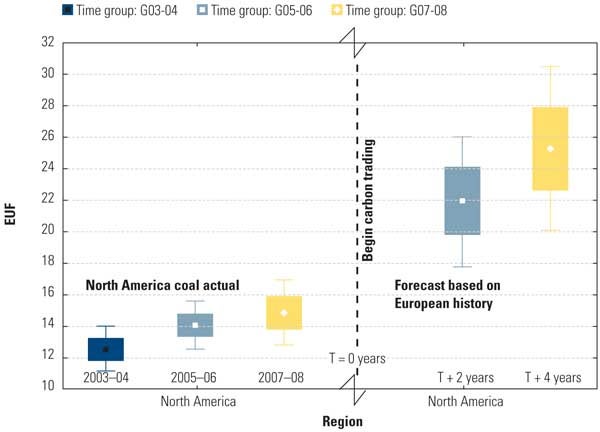

Clearly, carbon trading has had a significant impact on the utilization, reliability, efficiency, and costs associated with European power generation units. Carbon trading in Europe has redefined baseload and intermediate-load fuel and generation technology. North American coal and CCGT units will likely see similar changes. Figure 5 forecasts what North American units might expect in the area of coal-unit unavailability should European trends carry over to the North American market after a cap-and-trade regime takes effect.
5. Glimpse of the future
. Expect equivalent unavailability factor to markedly increase in North American coal-fired units should a cap-and-trade system be enacted. Source: Solomon Associates
North American unit unavailability in 2008 was at approximately the same level as European unit unavailability just prior to carbon trading. If we take the North American historical trend and forecast future performance based on Europe’s experience after 2005, we can predict substantial increases in the unavailability of North American coal units. Specifically, we can expect coal units to be used in a manner other than what was originally intended — for intermediate-load rather than baseload generation. This change in utilization will likely result in more starts and less run time per start.
