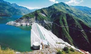

11.    Gating a goddess. After 35 years and an investment of nearly $1 billion, the 2,400-MW Tehri Hydroelectric Power Station in Uttarakhand, northern India, started operations in 2006. This hydropower project is one of India’s largest and most controversial. Located on the Bhagirathi River, a principal tributary of the grand Ganges River, it draws frequent protest from Hindus who resent the reduced flow of the sacred river as a result of the 855-foot dam (the fifth tallest in the world). Courtesy: Ministry of Power

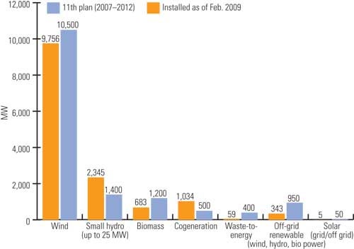

12.    Doubling clean capacity. India currently has 13,880 MW of grid-connected wind, small hydro, biomass, cogeneration, waste-to-energy, and solar power plus 350 MW of off-grid power, including captive power plants. The 11th plan seeks to add 15,000 MW of new renewable power, including 10.5 GW from wind. Source: Ministry of New and Renewable Power
Wind power, particularly, has seen stellar growth. During the 10th plan, India saw the installation of 5.4 GW, against a target of 2 GW. With 9.8 GW, India now has the fifth-highest level of installed wind capacity, trailing the U.S., Germany, Spain, and China. Tamil Nadu boasts the most wind power (about 4 GW), followed by Maharashtra, Karnataka (Figure 13), Rajasthan, and Gujarat. But though these states are also expected to receive most of the 10.5 GW of new capacity called for by the 11th plan, experts say that India’s wind power potential of 45 GW in 13 states — and up to 100 GW with current technology — will remain relatively untapped.
