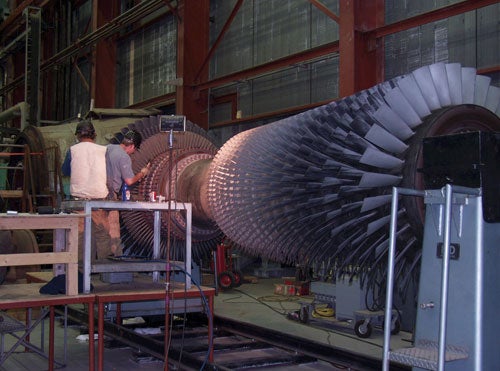

Chugach does use OEMs and/or independent contractors to repair some of the equipment at its plants as well as to refurbish certain gas turbine components. At Beluga, many of the repairs to gas turbine components are done on-site. For example, plant maintenance personnel use an on-site machine from IRD Balancing (Worthington, Ohio) to check for blade imbalances prior to installation of a new rotor on an ABB-11DM (Figure 5). The same technicians also repair gas turbine components such as combustion liners, transition pieces, turbine blades, vanes, and nozzles. Rotor and vane carrier rebuilds are completed on-site with refurbished or new parts, and Chugach maintenance crews have even coated compressors and restacked rotors at Beluga. Aiding the cause is a well-equipped on-site machine shop. Gas turbine disassembly and assembly during major overhauls is performed by plant maintenance personnel.
5. Balance it yourself. Plant maintenance personnel can balance gas turbine rotors on-site. Courtesy: Chugach Electric Association Inc.

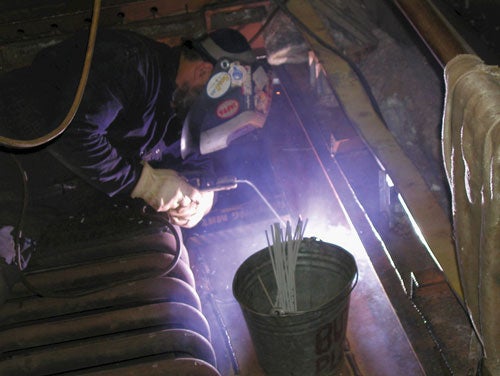

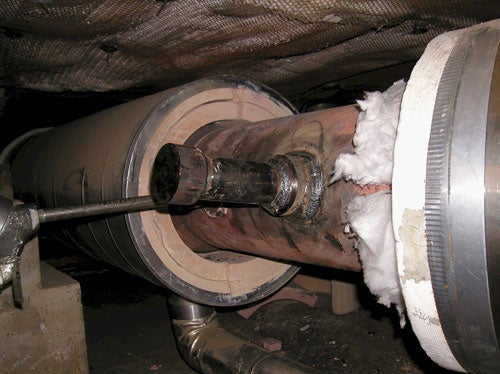

After more than 25 years of service, the combined-cycle unit at Beluga—like many elsewhere (see box)—continues to present challenges to efficient O&M. Mechanical wear has caused HRSG tube leaks that have required weld repairs (Figure 6). Because cracking of the high-pressure-steam attemperator liner in each HRSG has been endemic, technicians recently installed inspection ports to facilitate borescope inspections (Figure 7). Highly stressed structural components—particularly in the high-temperature region near the gas turbines' outlets—require annual inspections and repairs. Since they were upgraded, both combined-cycle turbines now must be operated with their bypass stacks partly open to maintain the temperature of steam piping below its design value. This practice has increased stresses and cracking damage.
6. Seal it yourself. Weld repair of an HRSG tube leak. Courtesy: Tetra Engineering Inc.
7. Quenching steam. An attemperator spray port installed to facilitate annual inspections.Courtesy: Tetra Engineering Inc.

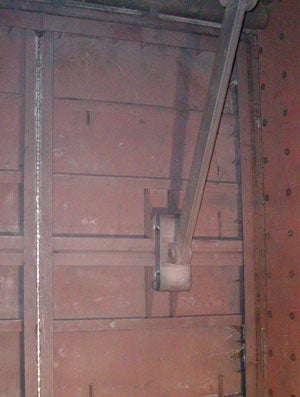

Flow-accelerated corrosion (FAC) wear is a common long-term problem at any combined-cycle power plant, and Beluga is no exception. Indeed, the plant's HRSGs include some carbon steel components that operate near the peak temperature for FAC wear damage (Figure 8). Difficulties with maintaining pH above recommended minimums, and years of operation with carbohydrazide (eliminated in the 1990s), have fostered long-term wear. More-recent operation has been at higher oxygen levels, and that has been beneficial, from an FAC perspective.
8. Just getting by. Structural repairs to an HRSG bypass damper. Courtesy: Tetra Engineering Inc.
