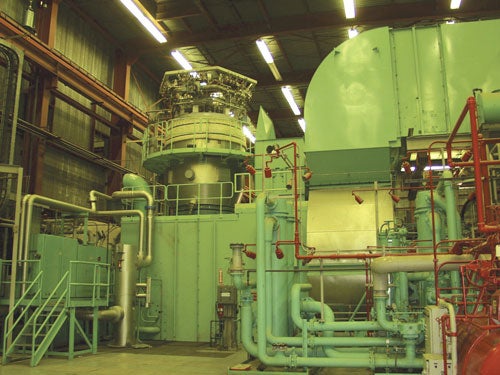

The newest, indoor ABB-11DM units (Figure 4) at Beluga were installed in the late 1970s, just as utilities began to deploy the first combined-cycle plants in search of higher efficiencies and lower heat rates. Remarkably, the units incorporate some design features common in today's modern HRSGs. Among them:
4. An oldie but goodie. The gas turbine powering Beluga Unit 6 is an ABB-11DM installed in the late 1970s. Courtesy: Chugach Electric Association Inc.
  • The use of gas exhaust bypass stacks to accommodate simple-cycle operation.
  • Interstage attemperation sprays to control main steam temperature.
  • Dedicated sprays to control the temperature of bypass dumps to the steam turbine condenser.
  • Motor-operated drain valves on high-temperature modules.
  • External deaeration systems.
