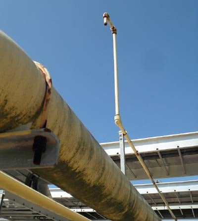

4.    Vent safely. This is a typical piping vent. Unfortunately, it points straight down in an attempt to keep rain water from entering the pipe. Releasing a high-pressure line through vent configuration can create a ground level flammable cloud. Courtesy: CEC Combustion Safety Inc.

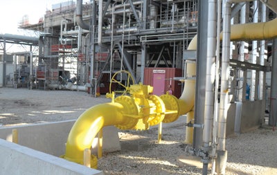

Even when workers attempt to isolate equipment correctly, we find that they often do not understand the issues surrounding lubricated plug valves used in gas lines. Lubricated plug valves, which represent 60% to 80% of natural gas piping system manual shut-off valves, have a small gap between the plug and the valve body. If a sealant is not applied annually, as required by code and the manufacturer, gas will leak past the plug even when the valve is in the closed position. We find that most facilities do not have the knowledge or the equipment to seal these and have never sealed them during the life of the valve. Hence, closing or locking out a valve in this condition does not necessarily isolate the energy source. The more serious issue is that if these are not regularly sealed, the valve can become impossible to close. This means you can have an emergency and lack the ability to secure the gas supply.

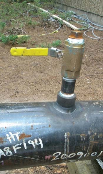

  1. Purge Points. Purge points are pipe nipples installed at strategic locations in the piping system for the purpose of introducing or removing nitrogen and natural gas at various stages of the process (Figure 5). These are generally 1-inch schedule 80 nipples (thicker and stronger than common schedule 40 pipes) with natural gas – rated ball valves on the ends. It is important to select locations or orientations that ensure that these are less susceptible to damage from things like vehicle traffic (being run into with a tow motor or scissors lift).
    5.    Good design practice. Typical purge points should be designed into piping systems. Courtesy: CEC Combustion Safety Inc.

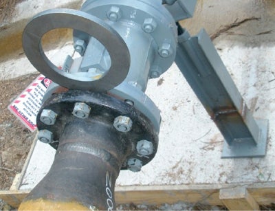

  2. Isolation Points. Ensure that your fuel trains are not exposed to excessive pressures that can damage components during pressure testing. Use line blinds to isolate components that are pressure sensitive. Valves can accidentally be left open or leak when in the closed position. Blinds provide positive isolation and eliminate the possibility of damaging devices in a fuel train that are not rated for the elevated test pressures, such as regulators and pressure switches (Figure 6).
    6.    Leading the blind. Spectacle blind installations should be designed for permanent insertion. Positions can be changed depending on the need. Courtesy: CEC Combustion Safety Inc.

  7. Discharge Locations. Make sure that purge end points where natural gas may be released are outside and located away from air intakes, building openings, and ignition sources. NFPA 54 has just released an emergency TIA (tentative interim amendment) that provides more details on this aspect of repair safety.
