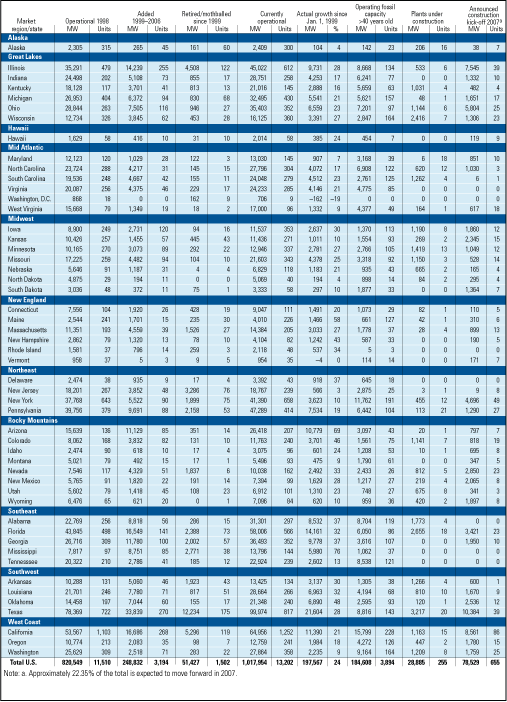

Industrial Info Resources (IIR, www.industrialinfo.com) contributed to this report by providing POWER with an exclusive summary of industry data covering the past decade that you'd be hard-pressed to find elsewhere. Table 1 is our industry report card detailing how the U.S. industry has kept up with demand growth over the past decade. The data, organized by market region, give a pretty good picture of where assets have been and are being developed. The rest of the picture can be gotten from an examination of regional capacity margins, addressed in the next section.
Table 1. Actual and planned U.S. regional power generation resource growth (1998–2007), by state. Source: Industrial Info Resources
Because it contains a wealth of information, Table 1 is well worth your study time. The "Plants under construction" category is current through November 2006. The number of plants with "Announced construction kick-off 2007" is based on direct customer feedback. The numbers prove that developers are perpetual optimists: History suggests that only about 25% of the reported plants will actually break ground during 2007, for a total of 19,000 new megawatts.

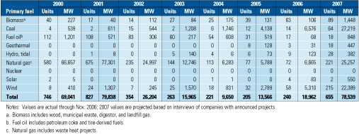

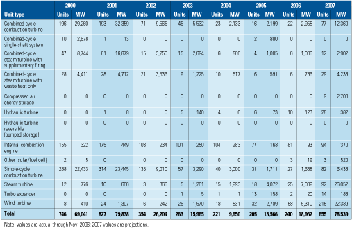

Slicing and dicing the IIR data gives other insights into what technologies are being selected (Table 2) and what the favorite fuels are (Table 3). Here, too, developers seem to be very ambitious when reporting project starts for 2007. For example, it's obvious from the bottom right corner of Table 2 that wind project developers are irrationally exuberant about the coming year, when they anticipate starting construction of 22,389 MW of turbines, with 3,500 MW reaching commercial operation in 2007. The American Wind Energy Association (AWEA) is also predicting that between 3,000 MW and 3,500 MW will be deployed.
Table 2. U.S. power generation resource growth (2000–2007), by generation technology. Source: Industrial Info Resources

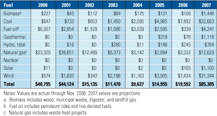

Table 3. U.S. power generation resource growth (2000–2007), by fuel type. Source: Industrial Info Resources

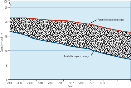

Margins falling fast. The bottom line of the NERC view: "Electric capacity margins will decline over the 2006–2015 period in most regions." This trend, according to NERC, is a product of the "short-term resource acquisition strategy" that has dominated for the past decade. Over the next 10 years, says NERC, U.S. electric demand is likely to increase by 19% (141,000 MW), while Canada's demand will grow by 13%. Yet the council says the projected level of committed resources over this period (Figure 1) will be a mere 6% (57,000 MW) in the U.S. and 9% (9,000 MW) in Canada.
1. Downhill slide. Expect U.S. capacity margins to decline over the next decade, although uncommitted resources may help reduce the shortfall. Source: NERC
