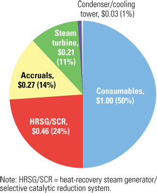

A good EOH program can also help justify the replacement of substandard components or the upgrade of an existing system (such as for water chemistry). In addition, it can justify taking action to address water chemistry or fuel problems reflected by higher EOH values. Finally, the actual operating and cost data developed by a strong EOH program are very helpful when developing dispatch cost and variable O&M cost studies (Figure 4) for plants that must routinely bid into competitive markets for operating hours.
4. Pay the freight.
This chart shows a typical distribution of variable O&M costs, in $/MWh, for a combined-cycle plant. A plantwide EOH program can make managing these costs more precise. Source: Tetra Engineering Group Inc.
