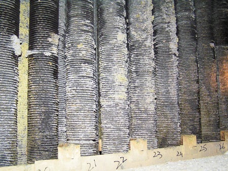

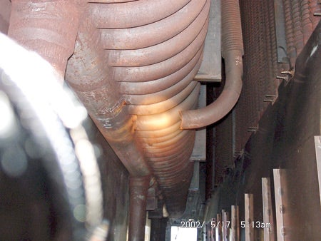

With the exception of turbines, the HRSG is perhaps the combined-cycle plant system that can benefit the most from a well-designed EOH-tracking program. Although HRSG suppliers typically provide limited recommendations for scheduled maintenance, HRSG users must have a formal and detailed program of inspection and cleaning in place to avoid serious O&M problems. Such problems can be caused by daily cycling, overfiring duct burners, large steam load swings, tube leaks, water chemistry upsets, short- and long-term layups, or fouling of a selective catalytic reduction system's (SCR's) catalyst (Figures 1 and 2).
1. Extreme service. This boiler tube was ruptured by cyclic fatigue. Many HRSGs designed for baseload service experience problems like this when pressed into cycling service. Courtesy: Tetra Engineering Group Inc.
2. Deposit account. These finned superheater tubes are covered by heavy deposits as a result of burning low-Btu gas with higher-than-normal H2S content. Courtesy: Tetra Engineering Group Inc.

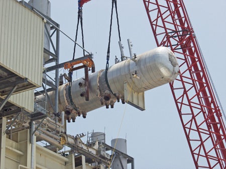

EOH formulas for an HRSG should be developed from a review of its design and operating history and based on a straightforward assessment of the lifetimes of major components. The assessment must include not just the HRSG's pressure parts (Figure 3) but also all of its ancillary systems: main stream valves and sprays, reheaters, duct burners and supporting components, and its casing and stack. Remember to include the post-combustion emissions catalysts and controls for the SCR and CO systems.
3. Beat the drum. This HP HRSG drum had to be removed to repair damage caused by a gas explosion inside it. Courtesy: Tetra Engineering Group Inc.
