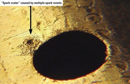

Minimize spark discharge. Most gas turbine lube oil filters show some evidence of spark discharge damage (Figure 6). The damage is caused by the buildup of static electricity, both in the oil and on the filters, as high-velocity oil flows through the tight clearances in the filter media. The damage is usually visible only at the microscopic level.
6. Blame it on the heat. The cumulative damage to a last-chance filter core caused by multiple spark events. Courtesy: EPT Inc.

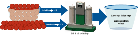

EPT uses its patent-pending ion-charge bonding (ICB) technology to remove soluble contaminants, like acids, from lubricants. Over two decades, ICB has been retrofitted to hundreds of gas turbines and electro-hydraulic control systems. The technology uses carefully chosen and treated ion-exchange resins to remove specific soluble products from lube oil. EPT's unique blend of resins and delivery methods can selectively remove soluble soft contaminants from turbine oil without disturbing other critical soluble components and additives. Returning to the bucket analogy (Figure 7), ICB treatment removes soluble contaminants from the oil and holds them in a filter, while electrostatic contamination control does the same for insolubles.
7. Double-barreled approach. Working together, two technologies—ion-charge bonding, and electrostatic contamination control—can remove both types of contaminants in lube oil that cause it to autodegrade. Source: EPT Inc.

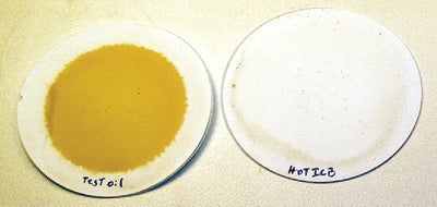

Dozens of laboratory experiments have studied ICB technology in this application. They are now being correlated with several field trials on Frame 7FA gas turbines and other systems. The patches in Figure 8 represent some typical results. A sample of oil was drawn from the reservoir and split into two equal measures. One was immediately treated with ICB, and the other was left untreated. Both samples were then aged for 14 days under identical conditions and tested using MPC. The whiteness of the ICB-treated patch ("Hot ICB") indicates that all soluble contaminants in it were removed, stopping its autodegradation.
8. Treated vs. untreated. The positive impact of ICB treatment on autodegradation. Courtesy: EPT Inc.

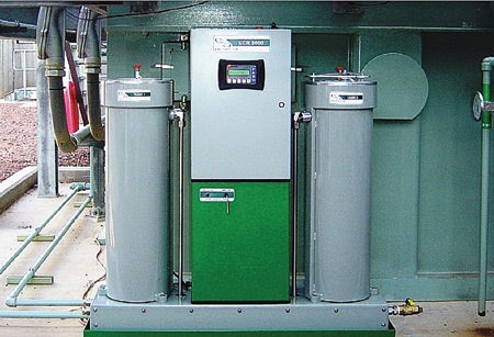

EPT has incorporated ICB technology into its electrostatic contaminant removal system, the ECR 8000 (Figure 9). The system enables removal of both soluble and insoluble materials from turbine lube oil using the same equipment.
9. Varnish buster. EPT's electrostatic lube oil cleaning system for large gas turbines. Courtesy: EPT Inc.
